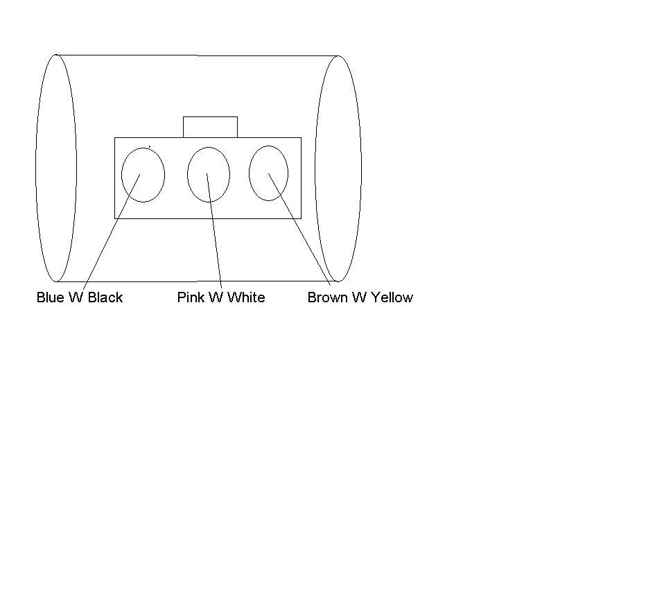

Hey guys i need a pic of the wires going to the mass air. There are 3 wires going to it and i ned the color codes and the order they go in.
This would help me out so much either a pic or read off the color codes and order its 3 wires thanks alot

yup, i can do that for you, your talking about the external maf on the 2002 ish 2.7's?

ok, if your looking at the plug from the top, with the tab that you press down on facing up
from left to right
blue with black stripe pink with white stripe brown with yellow stripe
this is off of a 2002 xl7
good luck

Perfect so just to confirm this is if you are looking at the top of the maf with the plug plugged into it.

Would you mind getting me a pic of the wiring? Cause something is wrong with what i got here. Thanks

are you positive on the wiring?
Reason is im putting a XL7 H27 maf on a gv with 2.5 ecu. My wiring on mine is blue with black/brown with yellow/pink with white.
They run both the same voltage outputs but i think i may of gotten a bad mass air.

This good enough?

Perfect thanks alot they wire it different on the 2.7 and 2.5
