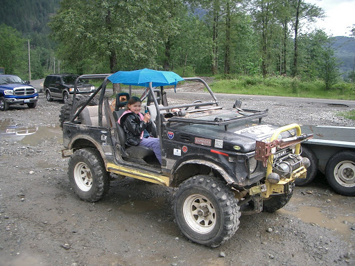

I have a RUF set up with a 2" Calamini rear spring and currently run 30" x 9.5" Maxxis Mudders. I have a 4" drop pitman arm and 1" driveshaft spacer. I am also running 1" wheel spacers and 1-3" lift shocks.
All of this is pretty low budget and is reatively easy to do with simple hand tools and a minimal amount of time.

That bumper looks like it means business!  More pics?

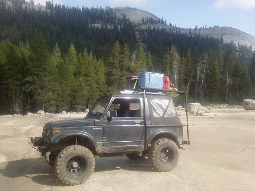

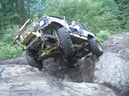

Here is a few pictures of the SPUA Sammy's in my club.  6" Calmini SPUA with 31" Swampers.   Really stable on the road, but they don't flex very well.  But that is what lockers are for, so you can crawl like a turtle.  The same lift is on both rigs, it was pulled off of one and installed on the other.
You can look up pictures at my clubs picture gallery site at http://picasaweb.google.com/CrawlersNW/
Its pretty much done now with the exception of a couple of recovery hooks to be added. Right now it is a little larger than life but once I slide the 34" Swapmpers underneath they should tame the size down some...
Then its on to the rear bumper for a 2nd generation make-over....
