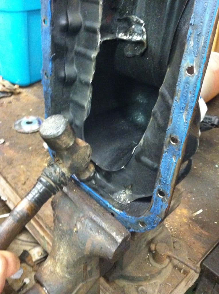

After reading some here I decided to tackle this myself.first I laid the to pans side by side to see what I needed to do to the baffles.i cut it out with a thin cutting wheel on my small side grinder.
This pic shows the 1.3  pan after mod.

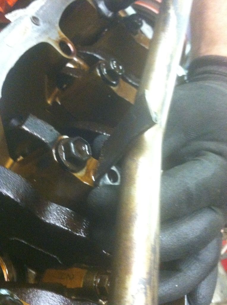

Next I knocked out the back of the pan a little to clear the main cap bolts.

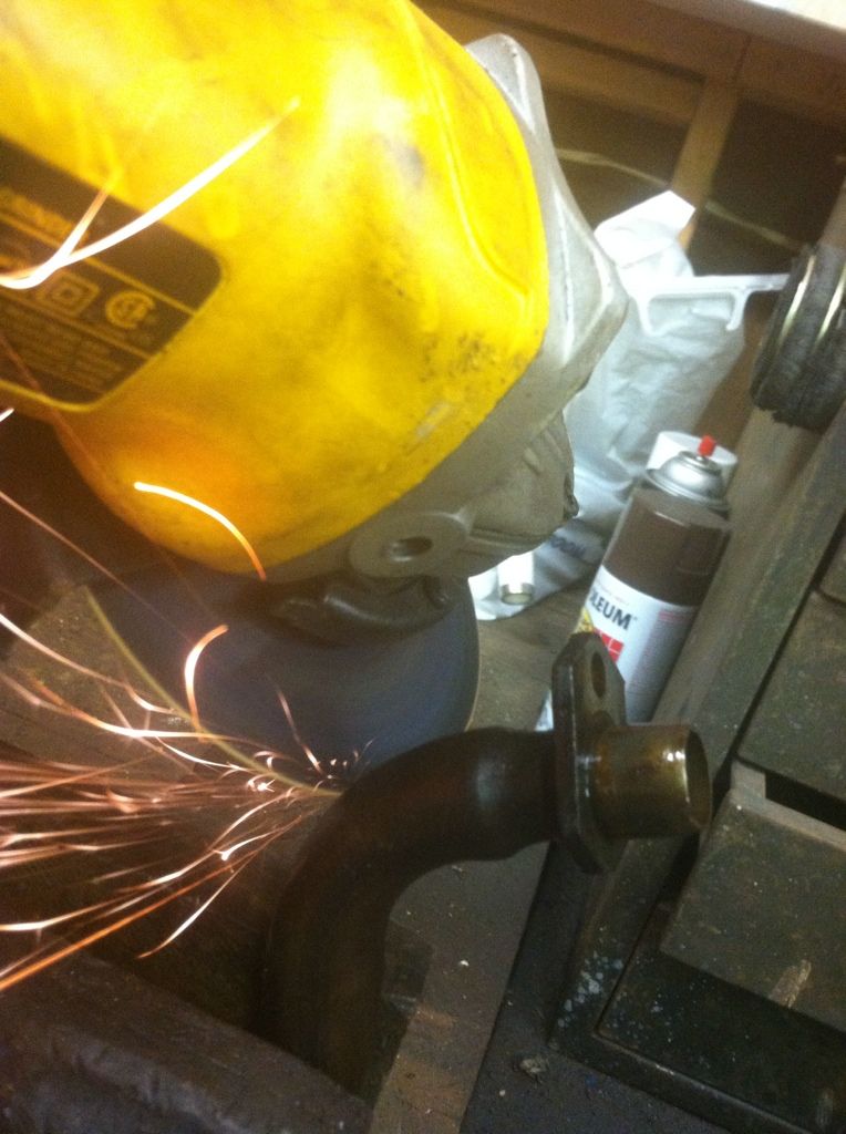

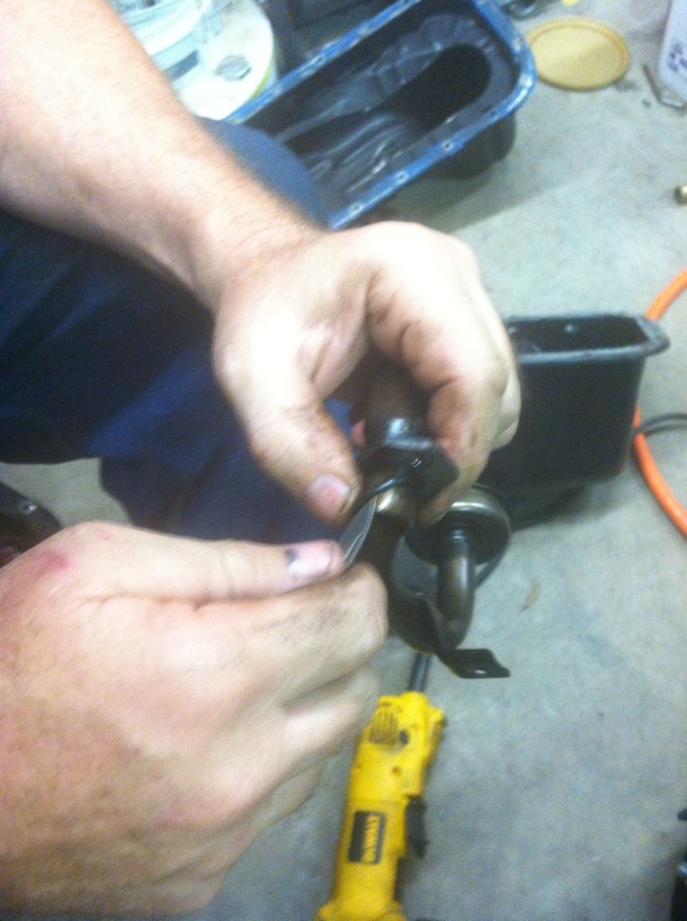

Next I cut the 1.6 pickup a couple of inches above the mount.
Measure the 1.3 tube and cut it off to go inside the slightly larger 1.6 base.

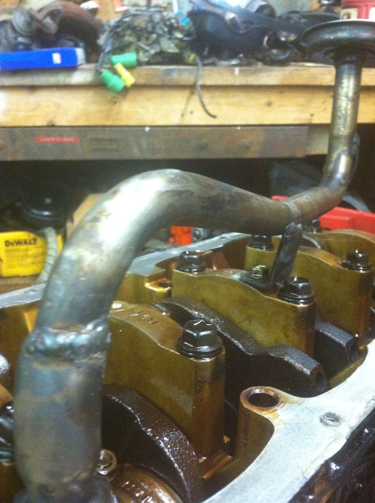

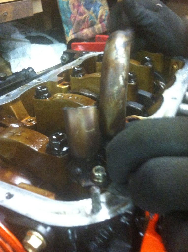

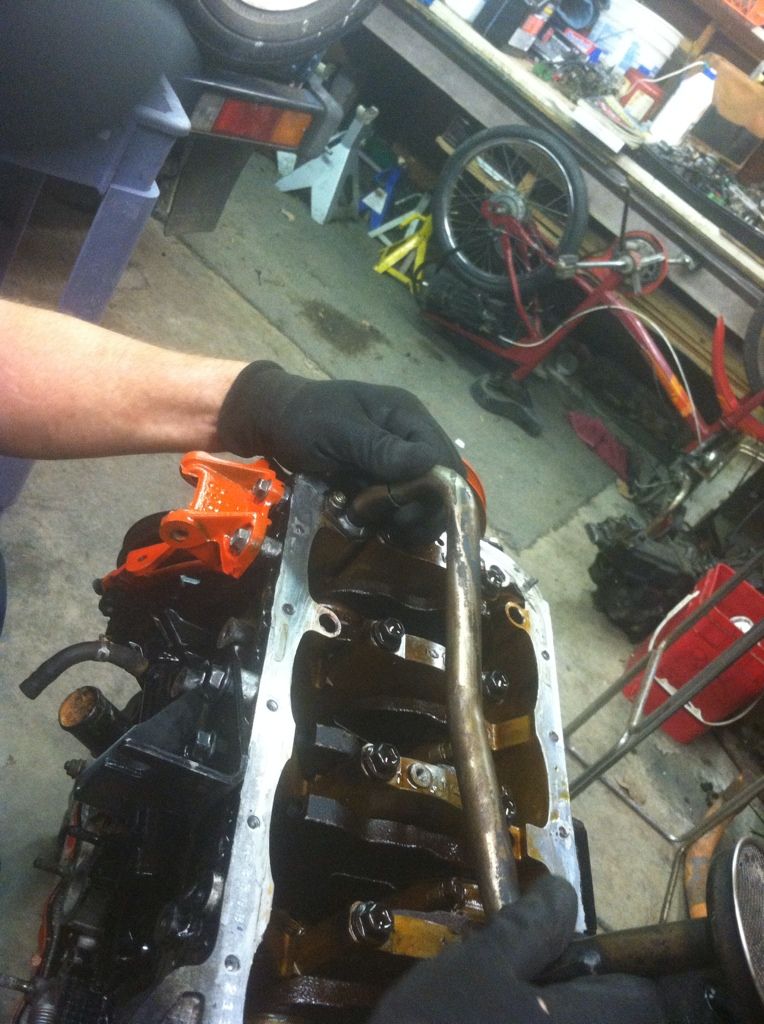

Test fit 1.3 pickup into 1.6 base.

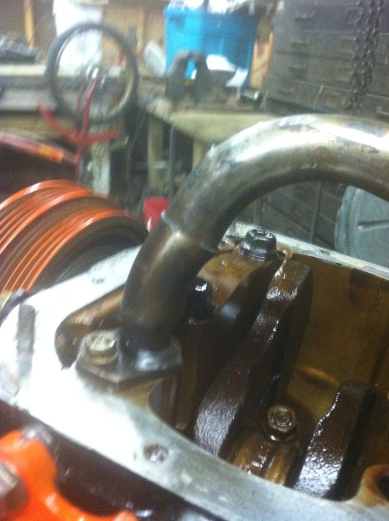

Tack weld tube and a bracket made from the old 1.3 tube moved to the mount hole on the 1.6 motor
Take it off and weld it all up.

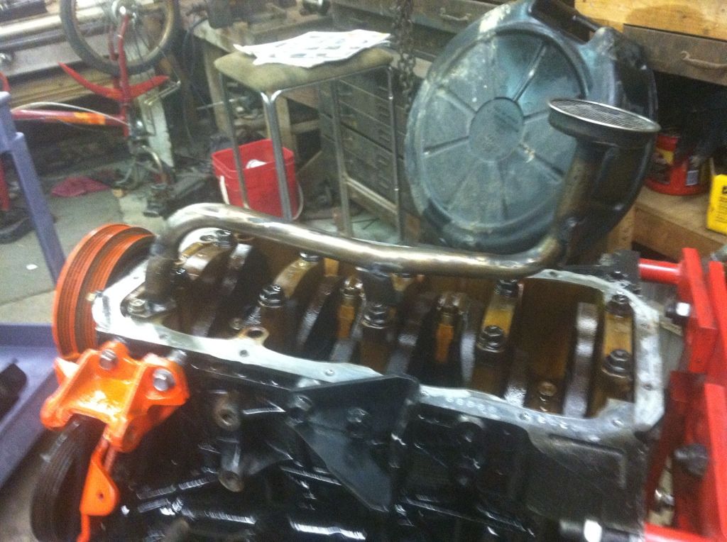

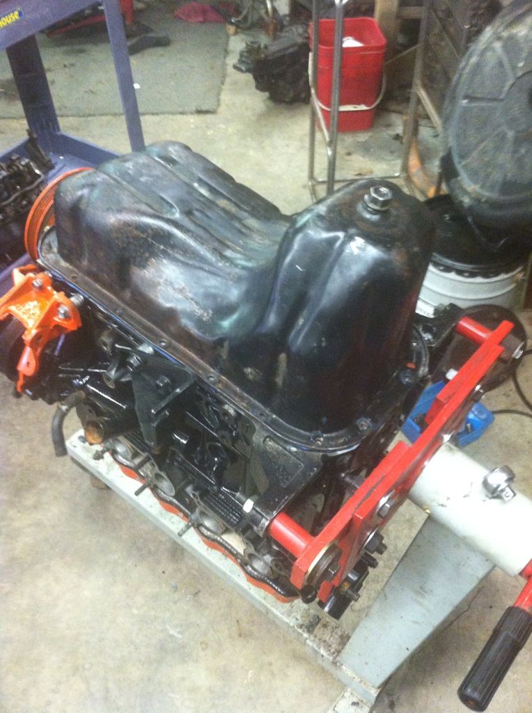

Test fit pan.

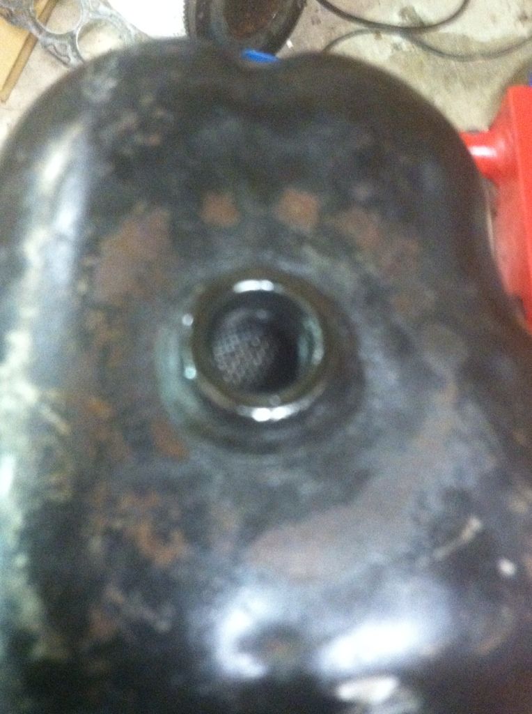

Screen should be visible thru drain hole,button up pan and your all done.
