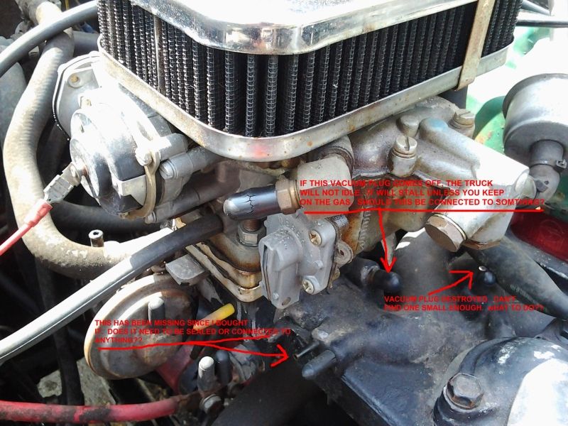

Two days after replacing the mechanical fuel pump on my 87 samurai, I was driving home from work and a vacuum cap under the carb blew off and the car would not idle anymore.  During one of my many stalls on the way home, I was slowing down with the transmission and something just changed in the way it was driving.  The clutch felt like it was engagine a lot sooner than before and out of nowhere i was hearing a popping sound when ever the engine would wind down (or when it would wind up during braking while down-shifting).  It sounds like excess fuel is being burned off.  I didn't notice the wobbly engine until I got home and replaced the vacuum cap.  It only wobbles when it idles.

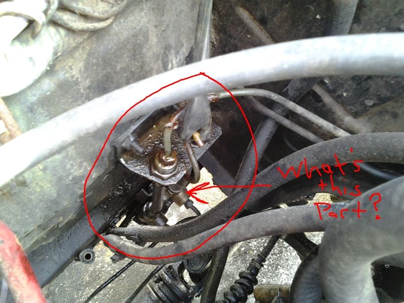

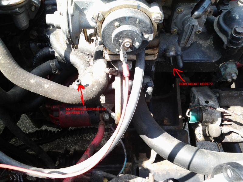

The first pic is a brake line. Fix it. Cap off ALL the unused vacuum nipples. Then if it still idles ruff. You may have jumped timing.
 If so it's not an expensive or tuff fix. The belt and tension-er is less than $30 at NAPA auto parts.

I also bought a ton of vacuum caps to seal off all the open ends on the carb., but sadly that didn't fix the issue :(

ok i think this case is closed.  I put all new vacuum caps on every loose end of the carb and around it and tweek the throttle just a little bit and it seems to be running extremely smooth.
