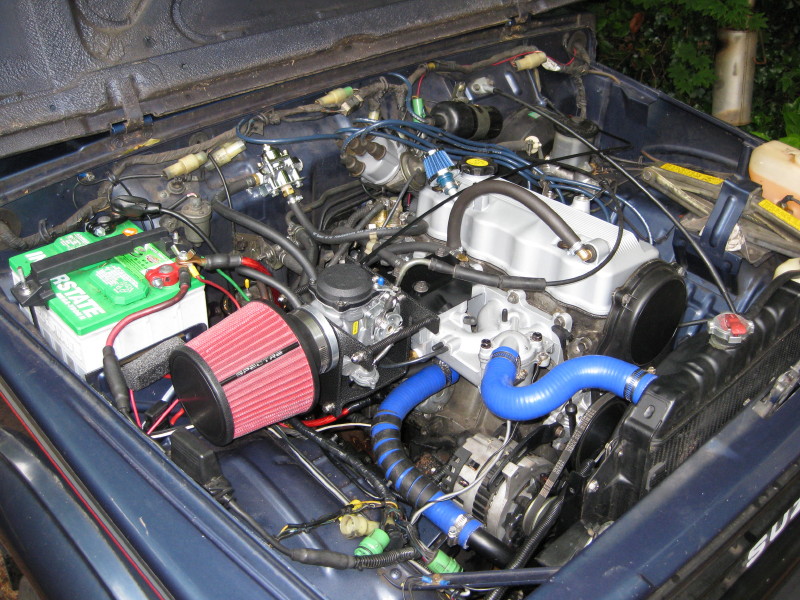

  • 76
Re: Metro aluminum valve cover on Samurai
« Reply #14 on: February 14, 2012, 10:52:32 PM »
Tux,
Here's a pic of how I did mine. I will get a better pic when I get home (in a couple of days). I'll see if I have info as to what gasket I used, where I got the filter etc.
Dave
