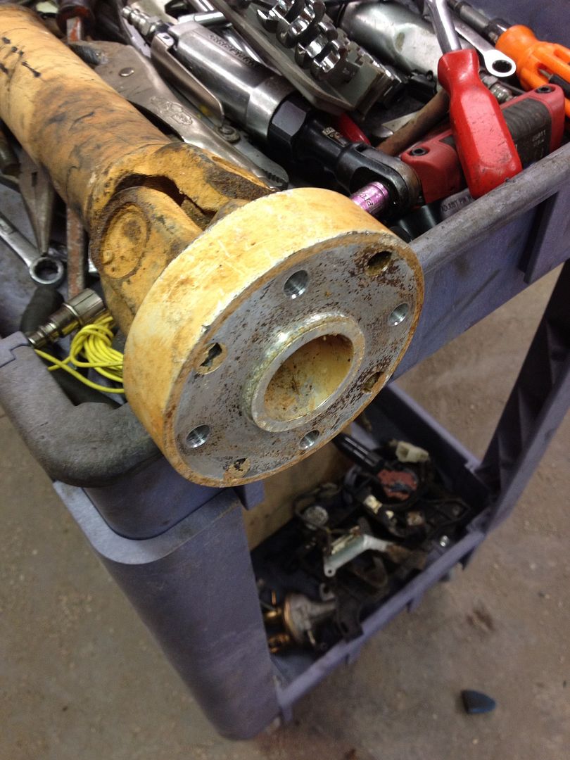

I brought a Sami that was completely disassembled and this adapter thing was on one of the shafts laying inside.anyone have any idea what it's for? It might belong there and i just dont recall seeing it before, Thanks c

It is a drive line spacer used on lifted zuk's does yours have a lift or spring over?

I'm with you now. Yes this truck was lifted. Thx. c

It also looks like a Toyota driveshaft adapter...
