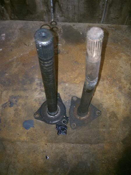

Below is a picture of an "original" intermiate shaft for the "driver side." They came from the junkyard and one has torch damage...This does show a visible comparison, and it is noticeable that the 26spline is bigger. Also the 26spline is not "reduced" down at the splines. But I still wander if I would break them....
