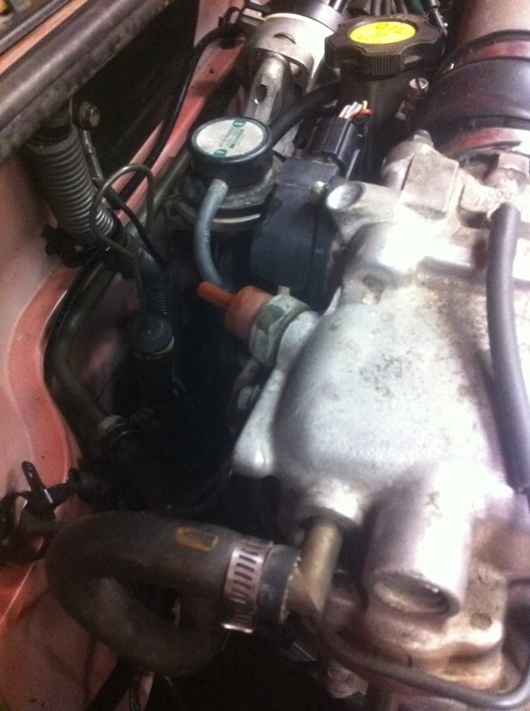

Dropped my new motor and this is the only puzzle peice missing. 95 geo tracker 16v 4x4 auto 4spd

Looks like the vacuum port for the auto trans
Yep, that is what it is.

Thanks guys was hoping to hear that just went for a test drive and the tranny was shifting funny so hopefully that's an easy fix!! LOL I was just reminded of the shear break horse power of this lil tracker. I drive a 97 Bmw m3 daily and there's no comparison  :D.

hmmm ??? hooked it up and it wont shift tell 4500 then down shifts hard as soon as it gets to 2700 rpms any ideas?

The 4 speed auto trans has an electric connection too, is it hooked up?
Modulator might be bad.

Well I pulled the vacum sender from the intake and cleaned it well. Moved a ground from the intake to the firewall and all seems to be working great. My guess is it was the ground. Just stumped me cause it didnt need removed to pull the motor.
