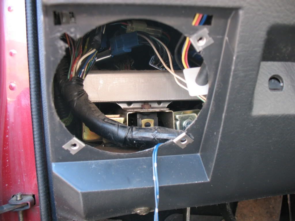

Post up a pic of the PCB and I'll tell you if its feasible.
ok, I went out to snap a pic and realized I have no clue where the PCB is located. Searching google tells me it is under the dash on the drivers side. is this the same PCB your talking about?
Is this what your looking for? The silver box?
