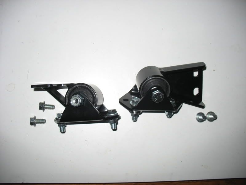

Well after going thru the originals and a set of brand new factory style trans and TC mounts in my Sidekick, I decided something had to be done and was looking at inserts to fab up some mounts, when I was looking at the directions for TT's undertaker and noticed they had a set of mounts and they looked, at least in the pictures, to be direct replacements for the stockies. So I called Brent and sure enough they are direct replacements, they just havnt had the time to add it to their online catalog.
Here they are the trans mount on the left and the TC mount on the right.

I do like that the "inserts" are rubber, they should be far better at dampening vibrations than a polyurethane style of insert. The inserts appear to be a cartridge type that is used in the factory truck A-arms, the part numbers on the insert cross to them.

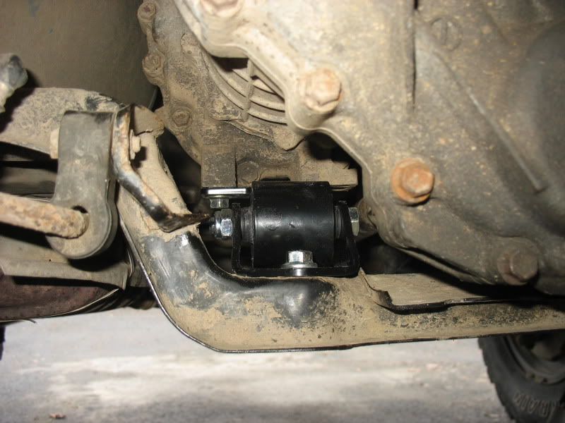

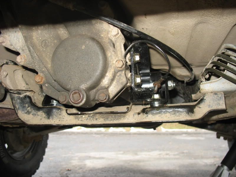

Well today was probably going to be the warmest day for awhile, 36 degrees. So I broke out a piece of cardboard and slid under the Sidekick to swap out the mounts. The OEM type pass side mount had already become a limp piece of shyt and had started to rip with just 300 miles or so on them.
Here are the stockies and the TT mounts
And here the TT's are installed
After installing them I had to go inside and thaw the fingers out and then took her for a spin. All of the drive train noises are gone, no additional vibrations are transmitted going down the road, you do have to be a little more gracefull with the clutch in the lower gears or you get a harsh engagement(trans/TC isnt moving around while under torque). I will check out the offroad performance here shortly.
