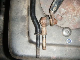

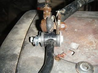

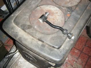

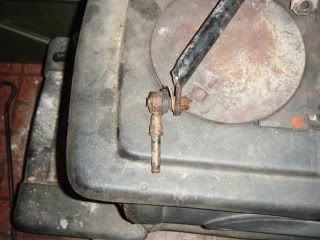

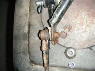

Stupid computer. I am having to use my kids' computer and the FUTTZINg card reader doesn't work!!!!!!!!  Okay. I took shots of the Jeep link to show how it is offset and it will work IF you cut the long leg out that is below the barrel bushing. Then weld the barrel end back on to the piece that you have left. Install the link, with the pin and clevis going through the ASB and then into the link. Shim with washers as needed to get correct fit, and install hairpin retainer clip. I used this set up on my old XJ with NO troubles EVER, plus it is a very common thing, even in the lift kits that you can buy. I did have to find a way to keep the ASB restrained so that it wouldn't fall down and get wedged into something. I used a "dogbone" type double clip hook for a dogchain and a loop of chain bolted in up under the fender to secure the ASB when needed.

 Go check out any Cherokee, and this is baiscally what you will see for the link/ASB setup. I am now thinking about putting the ASB BACK on, and making some links for it from the XJ stuff...
