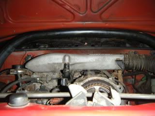

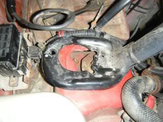

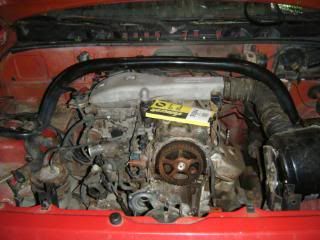

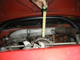

 I add a couple of "fitting" pictures to my thread this morning, so I will put them over here for you, and as you said, to help others in the future. I have to go get some cutting wheels and a couple of grinding ones to start reworking it, so just hang in there a bit.
 As you can see, this going to take a little bit of work to get it right, but it will be worth it, I think. Besides the price was right... FREE.
« Last Edit: December 22, 2010, 08:15:38 AM by Trackasaurouswrex »

Ohhh, hey yours is an 8v! That adds another twist, but I see you've already modded the intake so you have clear access to the left tower.
Yep, too wide & mount holes different, & now seeing the way the 'foot' is angled... once it's set down to the strut mount, will the 'heel' clear the inner fender? Maybe some cutting or BFH action needed? Also, in the 1st pic is looks like it'll clear the hood easily, but the later pics look like maybe not? Hard to tell if it's just the camera angle or could be an issue.
Thanks for the pics, keep em coming when you can!
