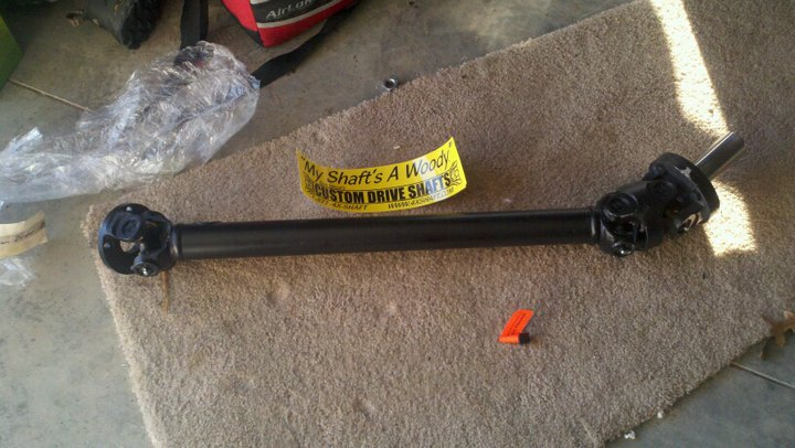

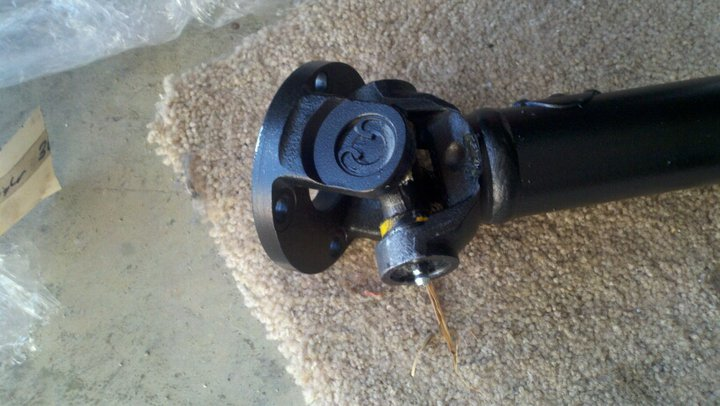

I ran into something similar with my Zuk. I did not want to go with a SYE kit due to the labor of installing the kit. I ended up calling Tom Woods driveshaft. They took my stock SY and machined it to a double cardan cv joint drive shaft.
With it mated to the stock SY and flange it allows removal (unbolting) of the shaft for trail fixes WITHOUT removing the SY stopping that annoying oil loss.
The back half is a upgraded U-Joint that should hold up to any thing me and the V-6 can lay into it.
Re: Long travel rear suspension without SYE
« Reply #3 on: April 26, 2011, 05:55:23 AM »
OK, so I tried the pics twice..... They show up good in my gallery, check them out there:
http://www.zukiworld.com/forum/index.php?action=gallery;su=user;cat=6;u=22
