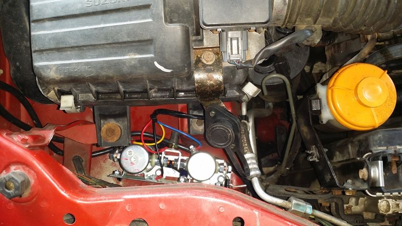

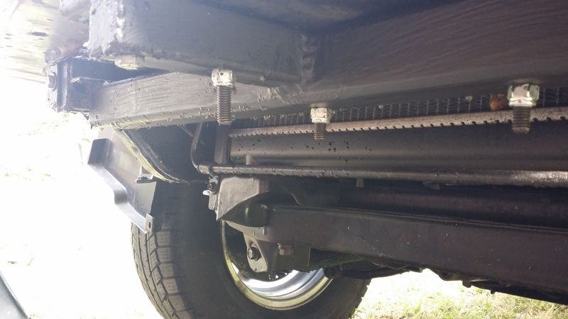

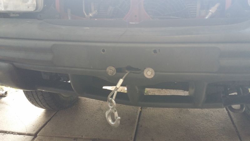

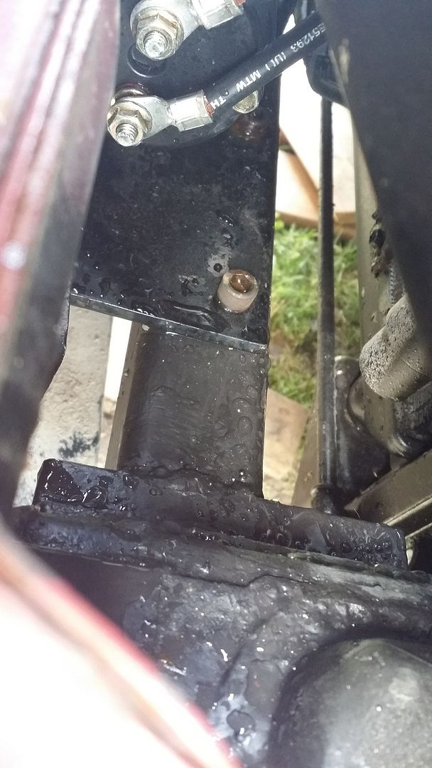

Offline bandit86
  • 1641
  • elv8rguy
Re: winch mount with 2" lift and original bumper in place?
« Reply #12 on: June 05, 2016, 03:38:19 PM »
It's a superwinch x3 4000 pound winch.  Mounted on a 2x2 3/16 thick bar, which is tied into a reinforced bumper.  The hook hides in a little cubby hole behind the license plate.  Can't even tell it's there.  To use, just unsure license plate, mount fair lead with 2 bolts.
