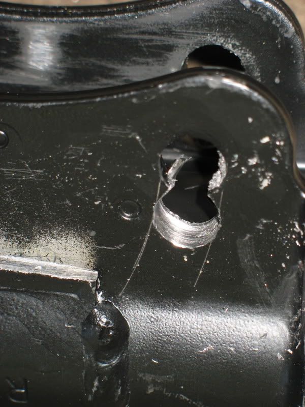

No need to purchase a camber kit, all that is needed is to slot the strut and you then have adjustable camber. I have never had a aftermarket camber bolt hold very well, they are easily half the dia as stock and simply are not large enough to handle the loads when hammering the truck. Besides the slot is free. I just drilled another hole and then afterwards used a carbide bit and a file to open up the slots. Works like a champ!!!
