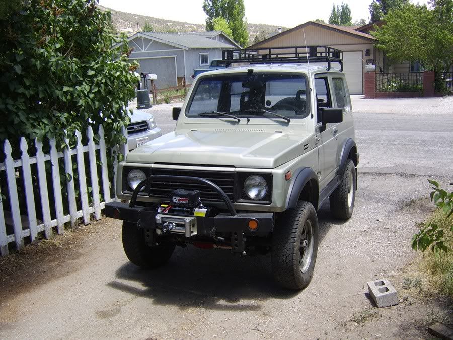

I put Calmini shackle reverse and OME springs. I like the ride a lot better. I did have to put on longer shocks and a drop pitman. Here's a pic of it with 215 tires.
