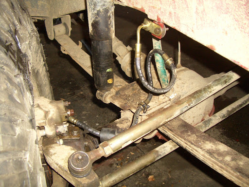

i think i need to do this too, i removed my overload spring but now its a little soft.. i have two full sets of springs  and im looking to add in one more. is no2 spring the best option??? got any pics of how they sit
Re: RUF leaf pack
« Reply #12 on: June 14, 2010, 11:56:32 AM »
Here is a shot of mine with the extra #2 in the pack with an RUF conversion.  It's with an SJ-410, so the springs sit a bit more inboard but the weight should be close to the same.  I think my engine might be a bit heavier...
