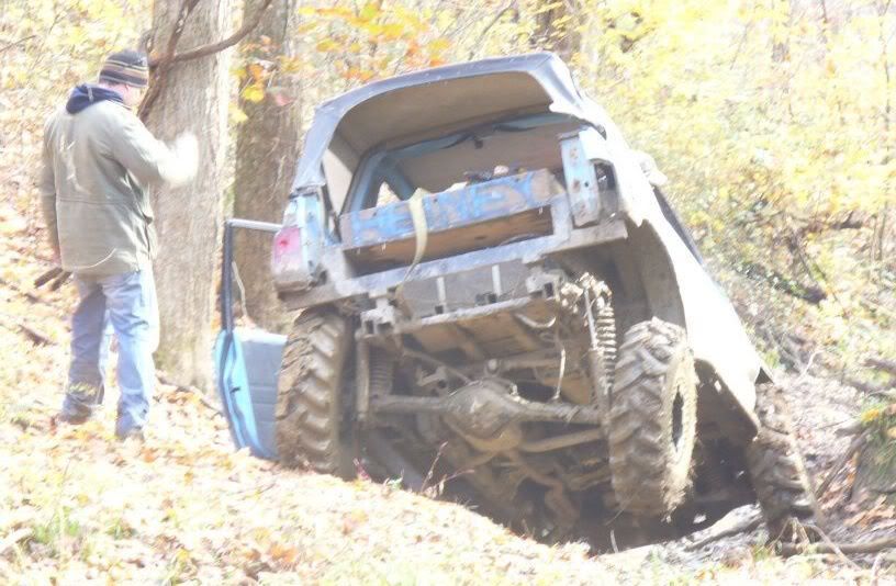

Hey all, suspension question for you, did some flex testing on the Sidekick last weekend and the shocks on there suck, really bad...  They are almost maxed out sitting flat, they have less than 1" of downtravel!  But 8" of uptravel...  I have a Calmini 3" lift, but I broke my Calmini rear shocks so I put on some old DT3000s I had laying around the garage.
Reading this doc:  http://www.trailtough.com/index.php?option=com_content&view=article&id=56:shock&catid=36:techinfo&Itemid=60  It mentions for rock crawling type of wheeling having only around ~3" of uptravel is plenty, and downtravel is much more valuable.
Current:
Shock mount to mount sitting flat - 22"
Shock mount to mount full compress - 14"
Shock mount to mount full extended - 26.5" (this is where the spring is just becoming unseated from the top spring mount)  I was thinking if I secure the lower spring mount with a strap or safety wire I could potentially go a few more inches because the bump stop on the top mount keeps the spring from falling out up top.  What do you think?

I agree that the uptravel is usually not as desirable for crawling. And your axle will still pivot around a bottomed out shock. I think I would go with the final option of a longer shock....if that is the only option. You could also move your lower shock mount if your handy to help tweak the numbers. I purchased some mounts from one of the vendors, and modified it to fit near the original location.
Also I strongly encourage some type of spring retainer. I tried to go with out them and lost a spring a couple times....So I just welded some "tabs" that hold my springs to the rear axle...I used some scrap 1"x3" metal cut 1" wide and then cut this into two sections to form two "J" hooks. I put two per spring, 180 deg apart. A quick and dirty diagram shown below. Sorry if this is confusing, there is probably a better solution.
______
|____ |
I don't really have any good pics of this cheap fix, but you can slightly see one in the picture below (driver side). When I flex it out the spring does drop off the "pad" as seen on the passenger side, but never gets below the passenger side. bumpstop.
Ultimately you do not want your shocks being the limiting strap or a bumpstop, because it shortens there life span. I've also debated getting longer springs, but I can't seem to justify it. Others are welcome to chime in.
