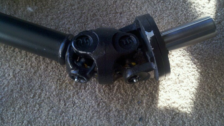

Sean at Low range off road has a brother who modifies the rear course spline output shaft to fit the fine spline slip yoke eliminator for the tracker cases. I think he told me it was like 60 bucks, maybe- but don't qoute me on that.

You going for something like this

yeah that's the ticket.. Was hoping to run toyota stuff but seems like the 1310 is stronger.. which means something else will break.. sooo yeah CV is the ultimate goal...
I think I will put a better paint job on it though.. whats up with that McFlakerson
