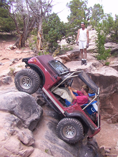

I cut a couple of inches out of the rear wheel well, but was able to run 33x12.5" tires without rubbing with a straight SPOA:
Lost Zuk is correct though in that you will likely rub. I also took a hammer to the back side of the inner fender well.
