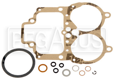

This is the gasket that you do not want to use.  Notice the third hole to the left of the two air corrector jets.
Offline Jonny Rash
  • 1094
  • 21
Re: Weber 32/36 DGAV starving for fuel
« Reply #9 on: February 10, 2016, 09:30:22 AM »
This is the gasket that you want.  Notice that it seals off the bowl area.  The other gasket has a hole that overlaps the bowl and air corrector jet area.

Maybe the gasket is my problem.  It took me a while to figure out what you were talking about in the photos you posted (Kind of a 'Where's Waldo' puzzle)  but I think I understand.  I'll have to look at the gasket and see what I have.

And Johnny, I believe I have the 3 hole style gasket, but I could see easily the jets in the bottom of the float area thru this opening. I can still pull the air cleaner adaptor off to investigate, will try to get pix, small hole, the infa red range finder gets confussed on these up tight pix. But again, I running OK, "If it ain't broke, don't mess with it"

Running good again finally. Drilled out the JB. Jetted it back down to 130/140 primary/secondary. Thanks for the heads up on the gasket Jonny. I have the one with the third extra hole that doesn't seal between the bowl and the air compensation jets. I can see how on incline raw fuel could get through. All I have to do now is find the right one. Do you know where I can get it?  All of the ones I see online appear to be the wrong ones.
