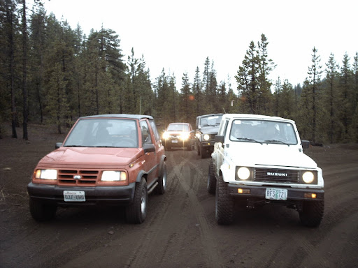

They aren't any worse on your bearings then offset tires.  But combined with off-set tires they can stick out there a ways.  I have run both 1.5" and 1" wheel spacers on my Tracker, I wouldn't go over 1".  Any further then that and your tires will rub to much on the back side of your fenders when you turn, especially when backing up.  An aggressive tread will probably also rub the top of your rear fender, but putting a 1" spring spacer in back fixed that problem for me.
Originally I bought mine on E-bay, just do a search for dodge wheel spacers and you can find some pretty cheap.  Just make sure they send you nuts for a Suzuki instead of a Ford, Jeep or Dodge.

They will rub because your wheel is further out so it changes the over-all arch of your tire travel.  Turn your wheel to full lock, the outside of your wheel is close to your rear inner fender well.  Move it out 1" in parrallel with the tread and it will be that much closer to the back of your fender well.  If you have room to spare then you can go with larger spacers.  Myself, I didn't.  I also had to trim the bottom of the bumper a bit as well.
I like the way it looks, especially with the fender flares.
Of course, the spacers aren't much cheaper then the wheels AndrewK picked up.  :D

The only problem is Im in Canada and the shipping would cost a crap load on those rims probably... Is that pic of the tracker with a 1inch or inch and a half spacer? And I wont have to worry about the front bumper I dont think since I have very little of one as you can sort of see in my display pic... The only area I'd have to trim maybe would be that inner rear front area. whats behind the black plastic there? is it just open space?

That pic is with a 3/4" spacer up front and a 1" spacer in the rear.
With spacers of more then 1" it's actually more of an adapter then a proper spacer.  So longer studs aren't really needed.  You might check with the local Canadian Tire or other tire store, see what they have available.  You have to pay tax, but you need to visit them to get the tires mounted anyway.
