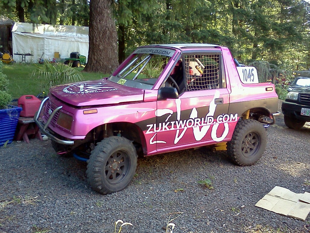

So the race is next week, time to start working on the race car.
The race winning thoroughbred has been put out to pasture since last year.  It fired right up.  First things first.  The steering reservoir outlet had broken off during the last year and had to be replaced.
Prior to work.
