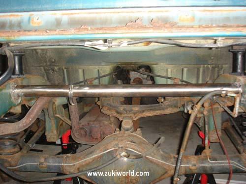

Nice tracker!! I just replaced the shock crossmember on my tracker yesterday. I used  1  5/16  sch 40 pipe, 43 inches long. I think 1 1/4 may have worked better. I had to taper the end on the 1 5/16 to get it thru. I just took the rear wheels off, oiled down the new pipe and slide it thru the shock towers. Weld the ends and you're done. I didn't have to take the gas tank out either. I plan on raising the tank this weekend when we put the body lift on so I"ll replce the mounts then.

I'm in the exact same process right now.  Trying to decide how to replace the tube, I had some dom scrap laying around, it's the size OD as the existing cross member.  Initially I thought I would be able to slide it right through, but that's not going to happen with out drilling out the section that runs through the rails,  so I think I'm just going to plat the ends of the new tube, and weld the plates on the inside of the frame rails.

SO, Today I found typical cancer on my Tracker. The crossmember that the front of the tank mounts to as well as the fuel filter is 80% gone. IDK how my tank didnt fall off when I was off roading last week.
Guess its time for body lift. If I'm going to drop the tank to cut out the crossmember and put a new tube in, I might as well get a 2" body lift and tuck the tank up higher when I reinstall it.

I just replaced that cross member, I also had to replace the rear portion of the frame though.
If you plan to raise the tank, consider a 3" body lift, this will allow you to bolt the tank directly to the front cross memeber and use the existing mounts on the rear cross member, I don't think 2" will give you enough clearance on the top of the tank.
I just finished raising my tank with a 3" body lift and it just makes it, I'll take some pics tonight and post them up.

Finally got around to bending and welding up the tube for the passenger side. Also cut 4 plates to bolt to the frame using 3 grade-8 1/2" bolts per side.
Stupid me, I forgot to weld the backside of the D plates for the shackles so now I have to do that or they could possibly rip out from what I've read. Oh well, shouldn't be hard to touch up the paint.
