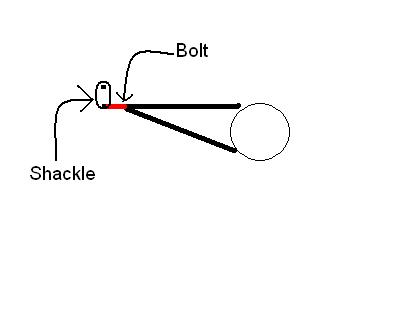

Regular bushings are fine.  I recommend using the shackle on the frame end with the triangulated traction bar.
I'll see if I can get some dimensions from the Samurai owner in my club that built his own and some pictures of his setup for you.

Regular dom pipe.  The shackle is allowing your axle to swing back and forth a bit along to follow the regular travel.  But the double arm system means if your springs are going to try and wrap it will have to the end up or down the shackle won't allow that.
Just make sure you use a bolt and threaded pipe or nut welded on the on the end so it can flex.  This will allow your axle to still articulate.

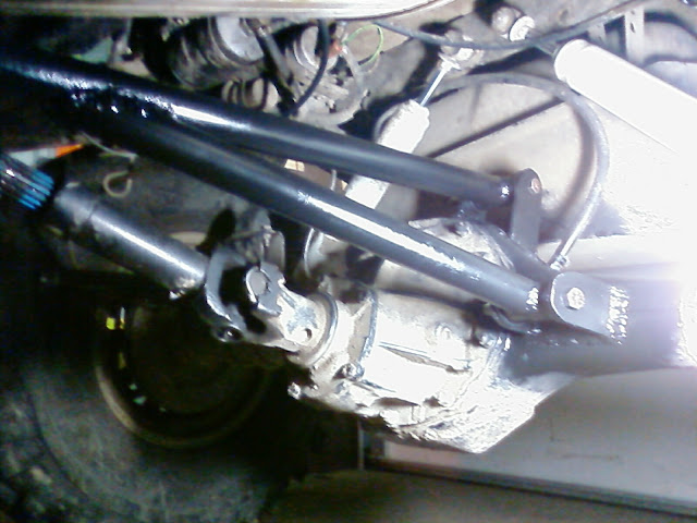

Got the Traction bar fabricated & fitted this weekend. Also went for a bit of off-roading this weekend with friends.
Must say that traction bar is a useful thing and I don't know if this is my gut feel or what but I can fell the reduction in slop in the driveline as well. Overall the transmission/drive has become more better.

Looks beefy!  How did you build your new upper cross member?  Any pictures of the 4 wheeling trip?

Here are pictures of the upper cross member. It is welded on a steel place and then a steel box has the metal/PU bush hydraulically pressed into it. The end of the traction bar at this point has a threaded bolt/head and is held by shaclkles.
