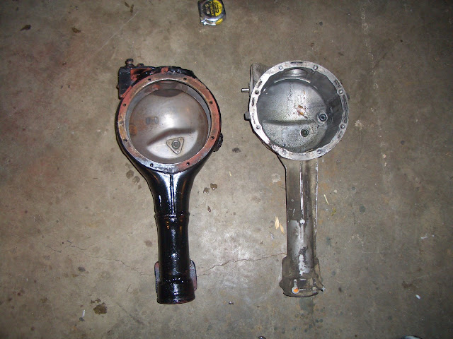

I am converting a Sammi rear end into a front housing for my tracker diff.  Everything went together exceptionally well.  I had to special order one of the seals (the other seal and bearings are the same as the trackers, and have just received the parts to put my tracker gears into Sammi diff.  Changing the crush sleeve is more daunting than building the modification.
On the right is my new front diff housing.
Re: 96 Tracker Front Diff. Madness
« Reply #7 on: December 15, 2008, 10:26:13 PM »
I don't think I've ever seen this done before! Brilliant! If you want to get really crazy, chop both sides, center it, and make long-travel IFS :)
