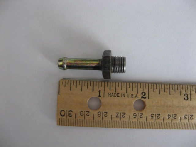

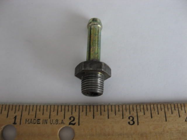

dres here are some pics of what you want to be looking for.  If you go to a junkyard just start looking under Isuzu's, Nissan's, and Toyota's.  Just look for hoses coming out of the top of the axles and heading up into the body.
They fit in your pocket so nicely too! ;)
4x4 nissan hardbodys are nissans 80s pick up.  IFS front, and a funny looking body.
