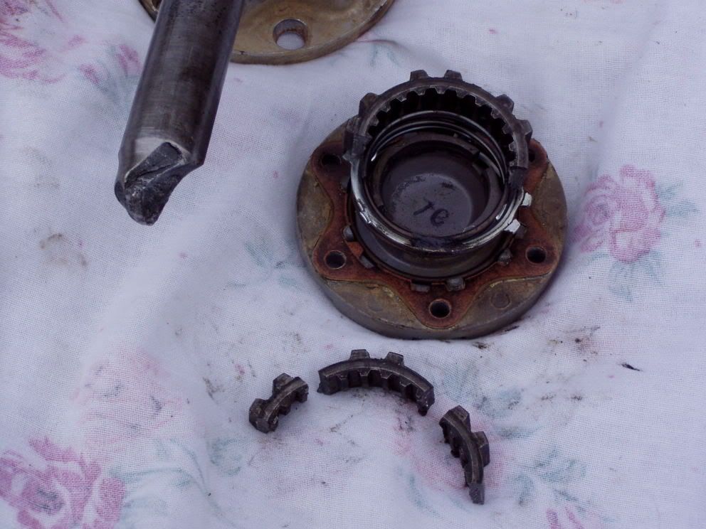

If you are lucky, it will be a birfield.  Even without rings, you might be unlucky and find this:
