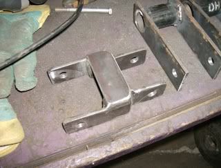

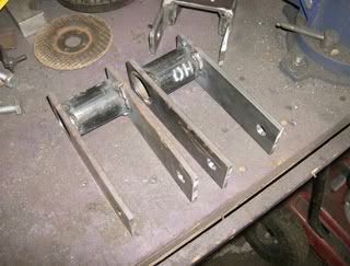

It's probably not the best way, but we've done it to several. We make longer spring shackles for the front and rear out of angle iron. We only modify the outer ones on the front and rear. We don't raise the inner shackles. We usually add about 2". It doesn't raise the vehicle much but with the biggest tires for a Sami (235X75R15 I think), it is enough for off roading and muddin' without heavy modifications of drive train and steering.

I've got 30" BFG muds on my 413K and all I've got is a set of home made revolver shakles that are about 2" over stock length when closed. Around here tires can't rub for the vehicle to pass safety but they are not 100% strict as long as they don't rub when driving normal. Full turning radios is required.
