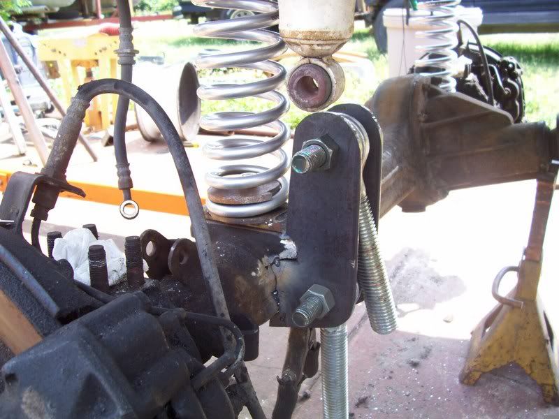

nunk74 heres the rod ends I used. I can get better pics if needed. There just cheapo tractor links from Tractor Supply. Im not sure how long they will last but like I said I was trying to keep it cheap. Im probably going to use bushings at the frame and upgrade to better hiems on the axles when I get closer to finishing.

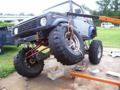

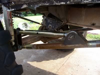

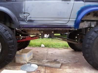

Distant, I didnt use a 4 link calculator, Kinda just did it. I looked at a few pic of other peoples 4 links and went fom there. The back is a triangulated 4 link and the front is a 3 link with a panhard bar , I tried to keep the angle of the PH with the steering draglink . I used the smaller heims with all the steering, still I will upgrade as needed.
heres the back
and front you can see the panhard bar
