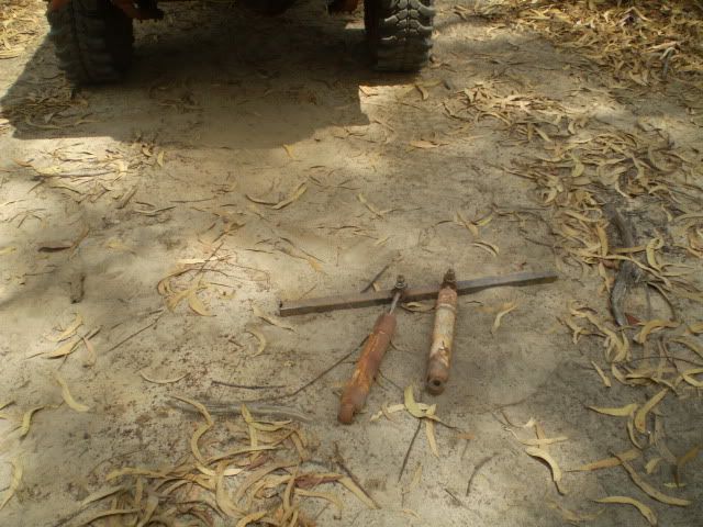

Offline shep
Re: Ever run with no shocks?
« Reply #10 on: June 01, 2010, 01:12:50 PM »
my rear shocks fell off 6 months ago and it took me 4 months to put them back on. i honestly
didn't notice any difference, i do live on a small island that has no real roads though so i dont know what it
would be like at highway speeds.
