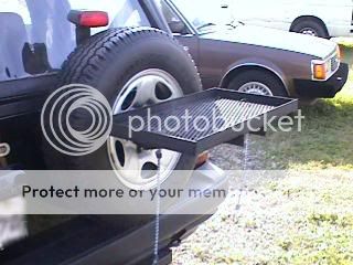

So I had some free time today, which I decided to spend on making some stuff for the Tracker.
First up is my TN_Tracker-styled tailgate rack. It's not a direct copy, since I don't keep a spare on the back, but rather cut the spare tire mount off and left about 1" of metal sticking out, which I welded the rack to. Here are some pics:
I can carry a gas can or a cooler, if I find one that is small enough to slip inside the angle pieces:
I also made a snorkel out of PVC pipe and some of the rubber fittings that came on the airbox of the Tracker. I'm going to add a little tube on the outside curly part where it goes into the fender with a drain plug in the bottom to attempt to catch any moisture that gets sucked in.
I still have to paint it/coat it with something and fix up the hole that I made in the fender to look a little better than it does now.

Nice to see my rack was an inspiration for you.
Question though, where's your spare?

Offline explosivo
  • 3157
  • I'm in the northern part of that one state.
    • omghi2u Gen. Discussion Forums
Re: My TN_Tracker-styled tailgate rack and PVC sno
« Reply #7 on: May 17, 2004, 02:58:47 PM »
lookin good dude...whats with the ratchet strap though?
I broke the body mount bolt on that sied, and a ratchet strap is much easier to use than fixing it right ;)
My spare I throw in the back, since it's not fullsized and looked funny on the tailgate. :)
I painted it today but didn't take any pics yet... looks pretty slick, IMO. Much better than the white PVC.
