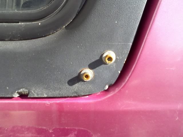

My hardtop on my 04' track mounts with only two bolts on each side up in the front corner. I am thinking maybe there should be a couple more on the back corners.

Is that on the outside of the truck?  That does not look original. That would make it easy to steal.  It appears those bolts were added. My hardtop has two plates mounted on the inside at that location and two plates mounted at the inside rear.  Those plates then hold the hardtop with large 3 inch round knobs that screw into theaded holes in the hardtop.

It looks like someone added a couple of bolts.
The Removeable Hard Tops that I've had have looked similar to skitime's pictures. Other than that, they kinda fit snug in the channel around the rear and targa bar. Then, once you shut the tailgate, that secures them too.

The previous owner has half a$$ed everything on this tracker so I do not doubt that it is not mounted correctly . Ski, Do you have any brighter pics you could get me and how the knobs are mounted to the hardtop ?
I will need to make me some brackets or buy some used ones.
I didn't think this was right , as it would be difficult to remove the hardtop quickly when you wanted to.
