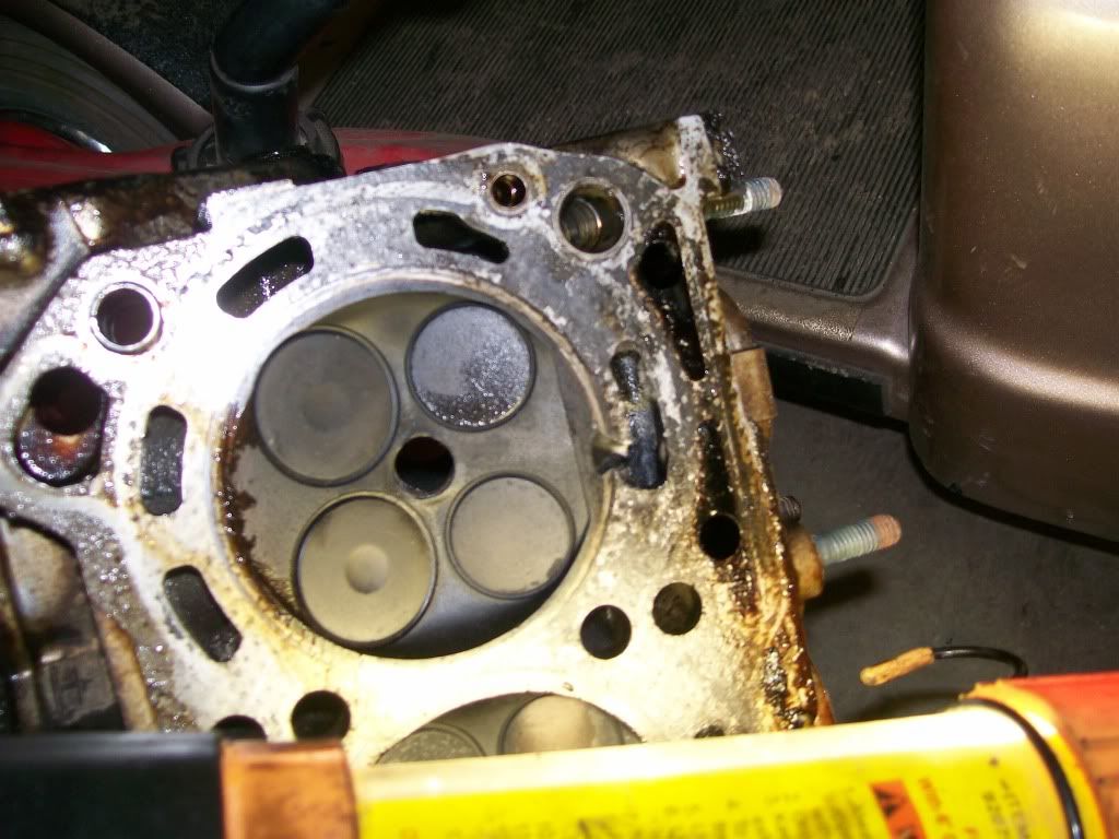

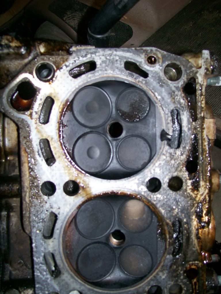

Well I took it apart and this is what I found
I think it got a little hot LOL
The head bolts were all finger tight or close to it except 2 in the middle. I got worried about reuseing them so I ordered new ones.

you dont ever re-use old head bolts anyhow.  if you take em out, REPLACE em.   thats the proper way.
