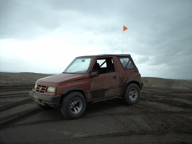

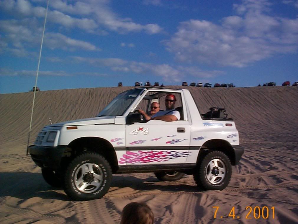

Here's a picture of my with a 3" calimini syspention lift and a 3" body lift before the new tires.  Old tires are 235/75/15's.  If I was leaving the 235's I'd do the susption only.  If nothing else do the suspention first and see.
Here's one with only the 3" susption lift.

Thanks for the visual, and nice rig by the way.
