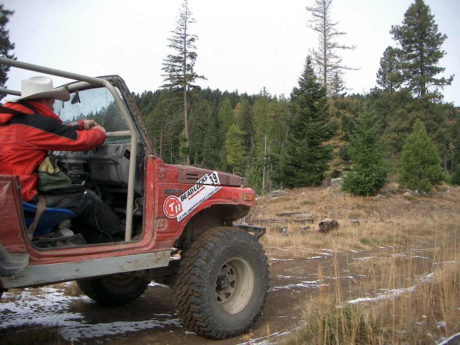

Trail Tough YJ missing link kit.
Better ride and more flex.
I added a second main leaf to the 5 pack springs on each corner and it made spring wrap a non-issue.
Here is how mine sits with 31" tires. Rides good, flexes decent, and spring wrap is not an issue.

Your TT looks really nice, but IMHO, it is way too high for the tire size.  I also had the 5-leaf packs and had a lot of spring wrap, much more than the standard springs SPOA.
Really ?? .. more than a few people have told me I should leave it on 31" tires when I tell them I will be going to a 33" tire next....
They quit making these tires in a 31" so I will have to go to a 33" tire if I want to stay with this brand/model of tire, which I plan on.
My spring packs are not the 5-leaf packs you are talking about. Mine are 5 leaf packs with a second main spring (eyes cut off) and slid into the pack. This is how I got around the spring wrap issue and still do not run any axle wrap bar.
I have not read much about people bitching about the YJ setup. Most people wish they had done it sooner, love the flex and the ride. I guess this is a first for me. Alot of guys if they have spring wrap issues just run a bar such as the Spidertrax bar and then have zero issues.
http://www.lowrangeoffroad.com/index.php/suzuki/samurai/suspension-parts/spidertrax-anti-wrap-kit.html
According to Trail Tough -
They are saying the spoa kit is good for up to 31" tires and the YJ kit is perfect for 33" tires.
http://www.trailtough.com/index.php?page=shop.product_details&flypage=flypage.tpl&product_id=38&category_id=7&option=com_virtuemart&Itemid=53
http://www.trailtough.com/index.php?page=shop.product_details&flypage=flypage.tpl&product_id=36&category_id=7&option=com_virtuemart&Itemid=53
My vote would still be for the YJ springs but it would look funny on stock tires SO maybe go back to spua and YJ if you are going to run a small tire.

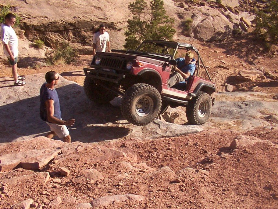

I think you could run 33" tires with stock springs SPOA with a little bit of sheetmetal seam tweaking.  I'm not totally against YJs though.
I ran my SJ-410 originally with a straight SPOA, fender trimming in the rear and a pounded in front fender.  I did run an additional long spring in my spring packs though, to make sure that the spring did not gain any negative arch.  Most SPOA builds tend to have a bit of negative arch to the springs after a while.  Worked great with some 33x12.5 BFG Mud Terrains.  When I switched to an RUF and some Pro-Comp Xtreme-MTR's though the tires rubbed on the front, so BRD HNTR helped me cut up the front fenders to better fit.
Original SPOA:
https://lh4.googleusercontent.com/-z7yQ7o6qyL8/SlQVvmFRsSI/AAAAAAAAEvo/-5fnZynqBlU/s912/DCP_0059.JPG
SPOA with RUF:
https://lh3.googleusercontent.com/-BcvMYCDD9Cc/RlcgoLeH06I/AAAAAAAAAH0/xPcecdgM0qg/s912/PICT0355.JPG
Front Fenders Trimmed:
https://lh5.googleusercontent.com/-dnVa7BCeNjQ/RwB-wgKmqYI/AAAAAAAAAw0/81eVZlnt9KE/s912/CIMG4318.JPG
On a note from each step of the conversion:
SPOA was choppy, RUF conversion made a HUGE difference in ride quality.  Switching to a 4-link on the rear just took it the next step, it is great to drive down the road now.  Just need to start taking it out more...

Yes, the RUF do make a big difference in ride quaility.  :) Did you keep the stock frame mount location and running missing links or extend the frame for the front shackles?  It looks like your axle is forward an inch or slightly more.
I ran a hybrid RUF pack for a while with the RRO kit.  Unfortunately I couldn't move the axle forward an inch (even with their adapter plate which just places the axle back the stock location) without redrilling the spring/axle centering pin hole.  A machinist friend advised me against drilling the hole, so I went back to the stock front springs which actually gave me clearance at the back of the wheelwell.  However, I do have a good bit of negative arch now, so I'm looking back at the RUF or a hybrid front spring back.
