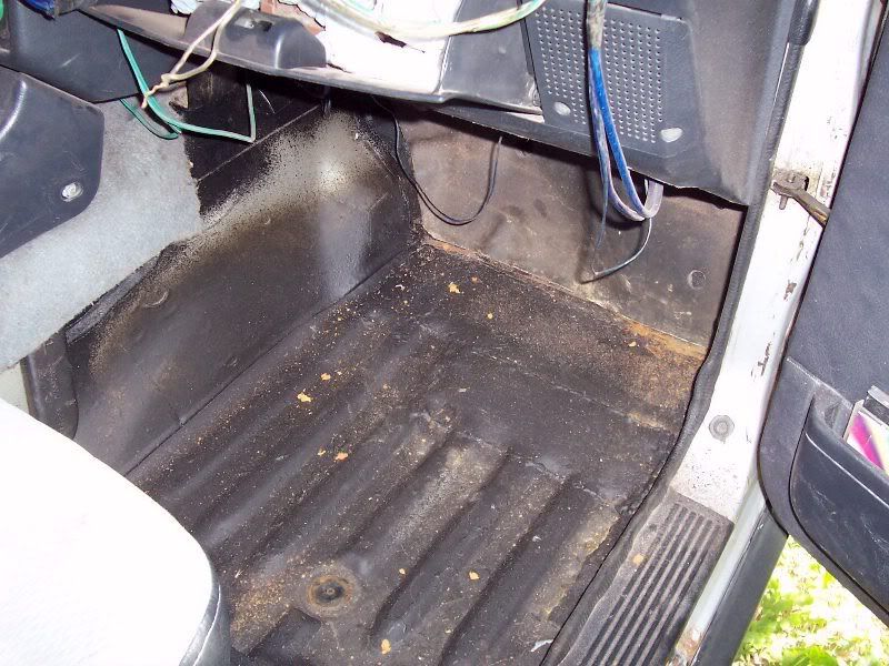

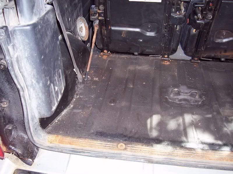

See attached. Damn the factory carpet and that rubber stick-on junk. I swear they put that stuff on JUST to put holes in the floor down the road.  My '82 Toyota was the same way.... Once it was all ripped out:
The front body mount on the passenger side is dead (Bottom image) -- Rusted completely through the under-floor brace, and then cracked off.  What are my options here?  I haven't had much time to really get underneath and check it out, but I'm thinking if I can get some thick sheetmetal under the floor, and if that bodymount/brace will come off, I'll find some wide rectangle stock tubing and just make my own.
There are a few more holes, but they're the sheet-metal, pop rivet and tar kind. I'm going to bedliner the inside when it's all done, and hopefully won't have to worry about this again.
I haven't found a place that sells floor pans, etc for these things. Can someone point me to a place online?  I'm up near Ottawa, ON (Canada) if anyone nearby has a welder and will work for beer.   8)

Shoot, you did good!  The hardtop alone is worth $500-600... used.
Just get as much rust off of it as you can,  weld in some scrap sheet metal from old hoods or door skins, pound it into shape and coat the whole thing with POR15 or Chassis Saver from Magnetic Paints
I can't tell a lot from the body mount picture, but making your own is probably the way to go.
I haven't seen replacement floor pans online.. or anywhere for that matter, but someone else might have.. I say just fake it...
