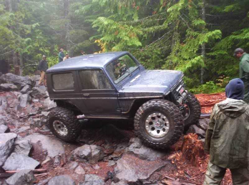

Yep, big tyres give ground clearance, the trick is to get them on there with the minimum lift. If you're going SPOA consider moving the front axle forward a little to get clearance on the footwells.
Very good example of that is this rig. It is super stable and very capable.
