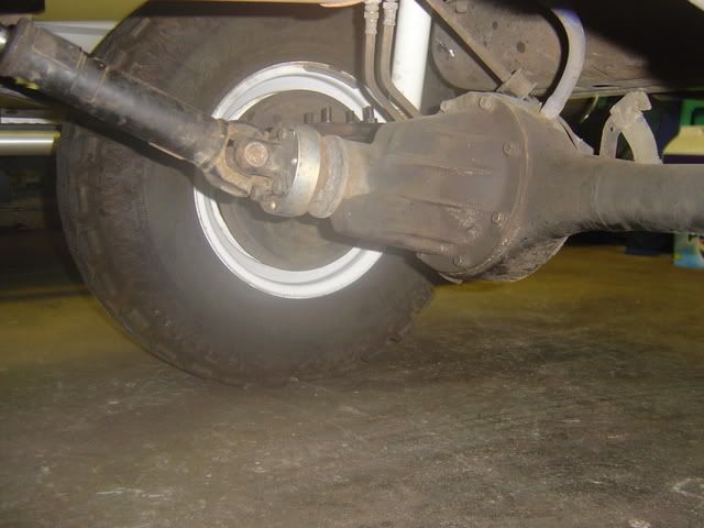

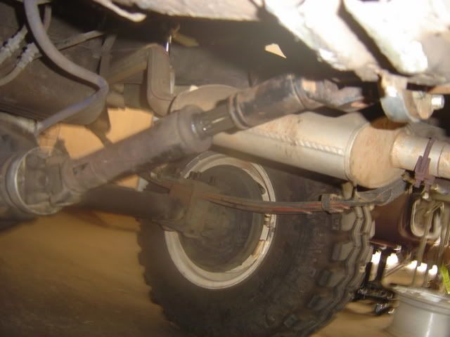

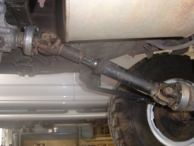

  Can you show me a pic of both the tcase and diff driveline angle at the same time?
Offline blasted879
  • 21
Re: sami drivetrain vibration???
« Reply #14 on: January 02, 2007, 07:39:12 PM »
and you think the spring can have somrthing to it too? see the first leaf?
