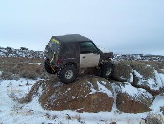

I did the same thing with Toyota Axel. Started spring under, just swapped to spring over, much better. whatever way you go, you wont regret it.
Spring over, you will need to run bigger than 31's otherwise they look way to small
in the pic just the rear is spring over and the front is spring over. 31" tires with stock YJ springs
this is with the boondox bolt on kit

I  meant the front is still spring under in that pic.
