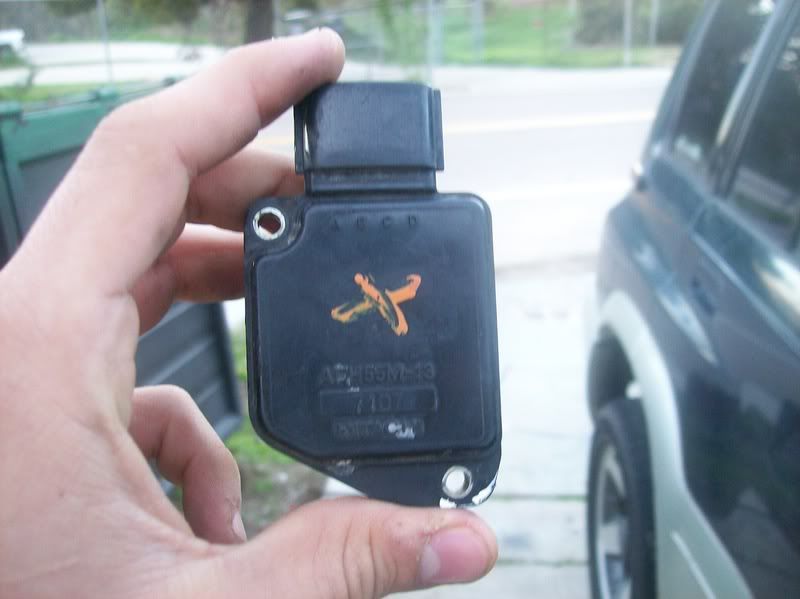

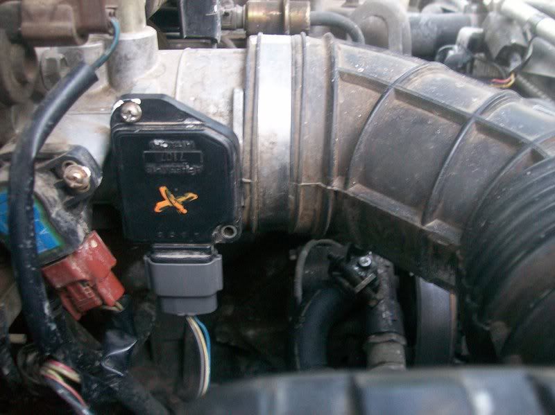

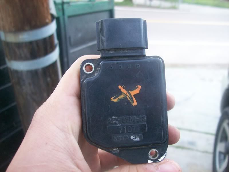

i went to go get the car back from the mechanic because he wasnt doing anything helpdul. i drove it back home with the same issues mentioned before except the car would stay at different speeds, it wouldnt up or downshift. i took it to a local mechanic & he plugged in with a scanner & told me this was the faulty sensor. i took these when i got home.
<img src="http://i73.photobucket.com/albums/i204/ecwrestler04/105_1129.jpg" border="0" alt="Photobucket"></a>
<img src="http://i73.photobucket.com/albums/i204/ecwrestler04/105_1124.jpg" border="0" alt="Photobucket"></a>
<img src="http://i73.photobucket.com/albums/i204/ecwrestler04/105_1123.jpg" border="0" alt="Photobucket"></a>
<img src="http://i73.photobucket.com/albums/i204/ecwrestler04/105_1121.jpg" border="0" alt="Photobucket"></a>
he cleaned & it didnt do anything, he called around looking for one & couldnt find one either.
i drove it back home & worked just great. i still drive it around town, sometimes it behaves, sometimes it doesnt.
i havent been able to find one.
maybe somebody here could point me towards one or have one they would like to donate...?
could i use a sensor from another car?
...which one(s)?

That looks like its just two NTC or PTC resistors rather than a conventional hot wire. Are there any markings on them? You should be able to test them with an ohm meter and a hairdryer.
