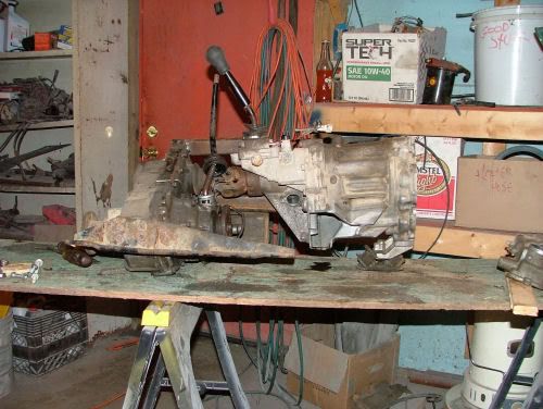

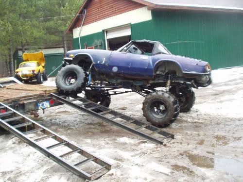

I cant seem to get pics to post  but here some photobucket
Is that a Fiat?
Nice.  Front end looks evil.  :)

its Triumph Spitfire.. Ive owned the yellow one in the Background since  1980
