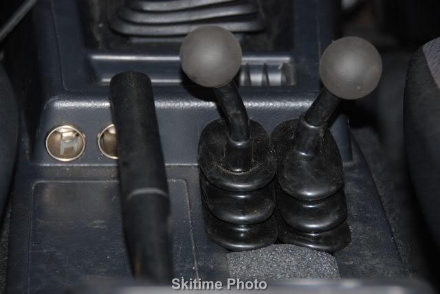

I have flat towed our Tracker for over 40,000 miles.  The real problem I have found flat towing the Tracker is when the transfer case is in neutral it is in 4 wheel drive neutral meaning if the rear dif is turning then the front diff is also turning even if the hubs are free wheeling.  This resulted in several worn out CV boots with our lifted Tracker until I made my own twin stick shifter. Now I can put the transfer case in 2 wheel drive neutral and I just got back from a 6,000 mile trip to Moab UT and Colorado flat towing the Tracker and the CV boots are in fine condition.

Holy hell Skitime that looks amazing!!!  How did you do that?
I adapted a Toyota twin stick setup. I developed the adapter and a CAD drawing for Front Range, hoping  would sell them but he has not made any yet.  http://frontrangeoffroadfab.com/nfoscomm/catalog/product_info.php?cPath=21&products_id=36&osCsid=75a585f8f3ec9926789adcba46a46fff
If you really want to have 2 wheel drive neutral the easy way is to disassemble your tranfer case, remove one dedent ball between the shift rails and then use a angle grinder to cut one new cutout on the left rail.  I was going to go that way but decided to develop the twin stick.

Yes that looks quite amazing and I like how it comes right out of the factory shifter boot opening.  Damn I'm gonna have to ask for pictures later on down the road if that's the way I decide to do it, cause nobody else offeres anything that comes close

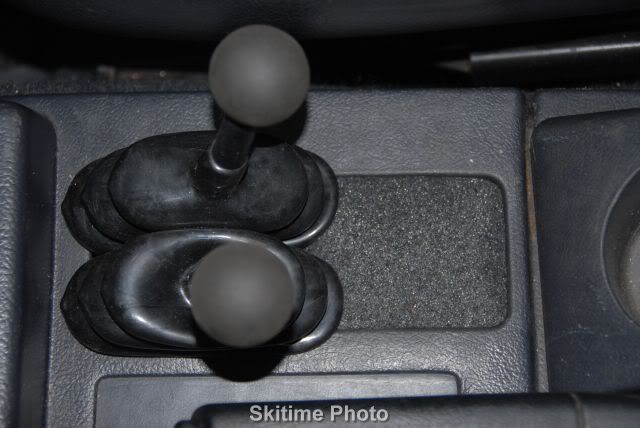

I used the Dana twinstick boot in conjunction with the standard boot. Apart from Stan (37kicker), Rock4xfabrication (rockrat) also offers a twinstick for a Kick too.
This in mine.
