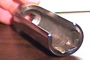

ok so i finally got off my butt to change the 02 only to figure out it isnt like a normal bolt..it wont budge!!1 and there really isnt enough room to lay the wrench down flat with the 02 so it would round the damn thing off....what kind of tool can i buy to make this easy?

Start your truck, let it run for 5 mins then have a go at it.
The heat from the exhaust make the threads in the manifold expand.
Make sure you don't burn yourself though, those manifolds get damn hot.

your two best friends when taking stuff apart...heat and a bfh.

Tough situation call for tough answers,
a 1/2" deep impact socket and an air
impact, cut the wire short (about 1")
and put the socket over the sensor,
if it will not come out, you still can hook
up the sensor with the short wire you left
Wild

buy an o2 sensor socket, its designed for that... cutting the wire works good to get it off,
and you could use a small wrench if it fits to get it back on, but i dont know how tight it'll go with a short wrench and how tight it needs to be
im cheap so if i didnt have the proper tool id just work around it

You can get an O2 sensor socket. It's a deep socket with a hole through the side in which you can pull the wire/connector through without damaging them. I'm not sure who else sells them, but I have seen them in my Snap-on catalogue.
 You could always take a perfectly good deep socket, and bore a hole through the side of it as well.(Make your own.) Hope that helps. <---Jay

this might help.
stu

i got the socket and some penetrating lube...hit the 02 twice with the lube about 30mins apart and she came out like butter =)...car runs SOOO!!!! much better now it idles so softly now i cant even tell if it is running sometimes
also it sounds different??? the engine sounds beffier now lol..dont know about that ::)
