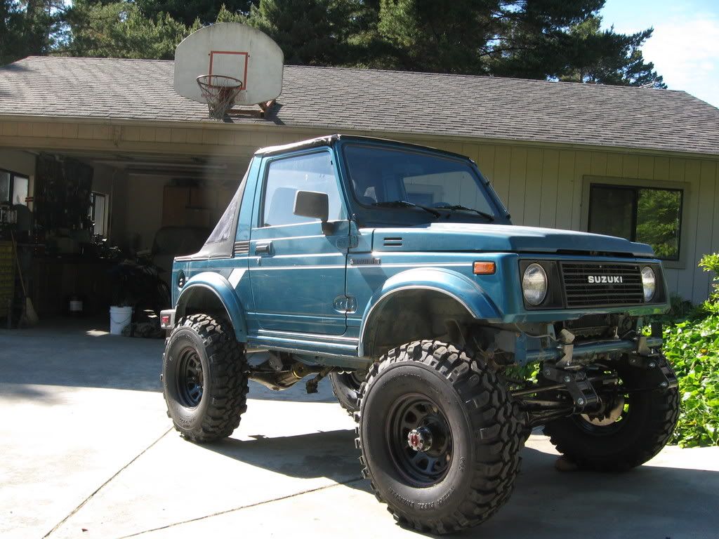

heres some pics of mine
88 1/2 sami,yj springs spoa, 33s

« Reply #4 on: July 23, 2008, 12:21:41 AM »
I know some of you guys might give me crap for doing this do a tin top but im in mn and our winters suck, it also looks about ten times better then when i first bought it
It looks like you make a miniature FJ-55...  :P
More on Topic a club members Sammy with a Spring Over, YJ Springs and the Missing Link kit on 33" Swampers sits at 20" to the frame.
