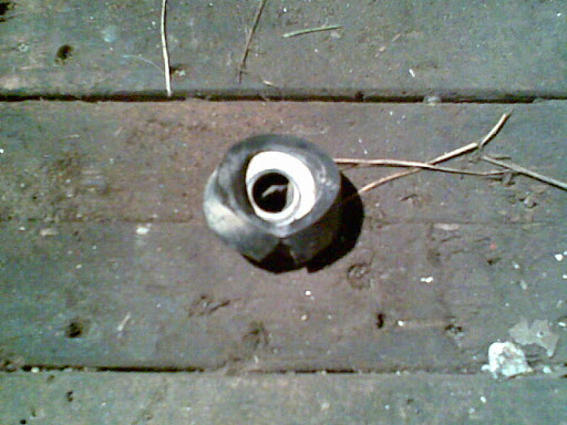

If you get the mounts but do not want to spring for the t-case cradle I would recommend beefing up the long t-case arm.  It is the one that tends to bend, so add a piece of angle iron to the long part to help beef it up and stop it from twisting.
As long as you keep oil in it and don't drop it on things the t-case should be able to hold up to abuse.
As for the Trail Tough alluminum bushings, they work great but they do make your entire chassis sing.  Especially if you have a bit of vibration in the drive-line.  Some people swear by them, I like to have a bit of flex in my bushings instead of hard metal.
When getting the bushing based bulletproof mounts make sure you use large flat washers on them.  I have the Rocky Road kit and the smaller washers will eventually tear through the bushings.  Some thick fender washers take care of that issue.
