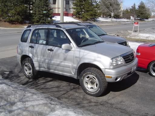

Took this past week off work to burn off the rest of my annual leave. JDMCRX and I installed the lift kit he designed and manufactured on my Suzuki Grand Vitara.
kit includes:

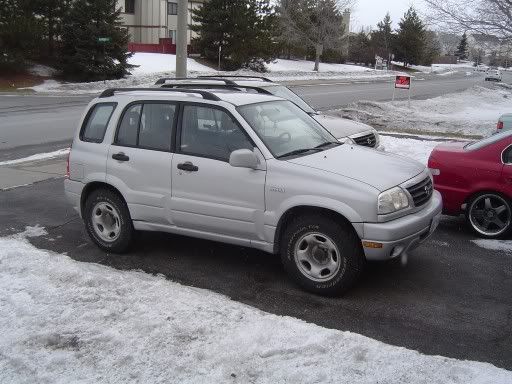

Here she is before surgery....

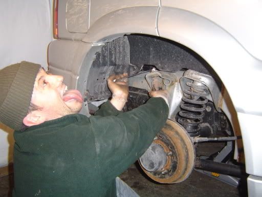

Me in mad scientist mode performing surgery...
I have a big tongue....my GF loves it !!
Here's some surgery pics....
We had to make some modifications in order to adjust camber like
slotting the top holes on the front strut mounts
and grinding some excess material off the spindle
Overall, it was a fun time. The front end was a bitch to do as my truck was uncooperative. A few hard to loosen bolts. Luckily his garage has a disgusting array of tools.

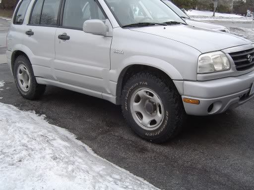

The finished product.
SHAZAM!!

Why'd you have to grind on the knuckle? ???

Cause when u lift ur truck ur control arms go like this / \ which gives u positive camber so u have to bring the spindle inwards towards the inside of the truck . Ill have the write up done tomorrow u will see why
