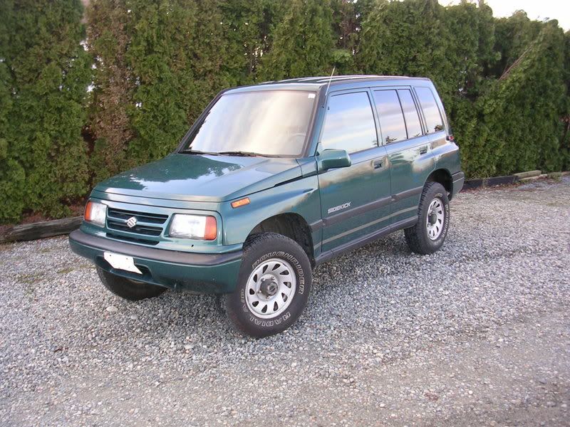

I have a 1.5" lift and 235/75 15's...no problems. Looks like I could fit a 30" tire too:

30's should fit with no problems... how much sag you have on the stock springs will dictate the size though.. with no say, 30's would be a piece of cake..roughly 1" difference between 235 and 30"..so with 1 1/5 spacers you should actually be sitting a little higher..just remember.. 1" difference only means 1/2" on either side for clearance..
