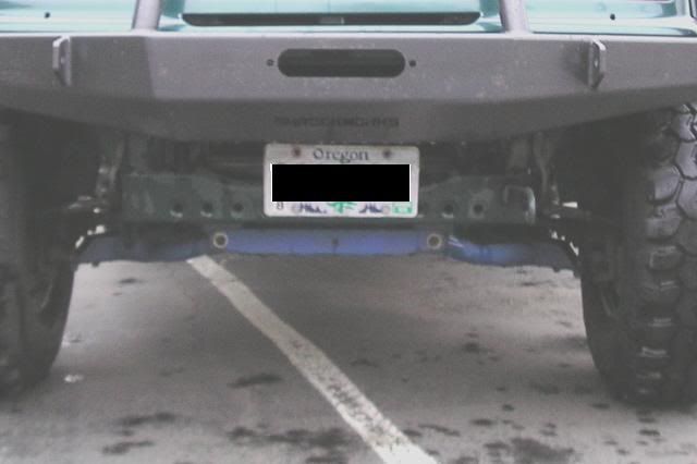

It really depends on your driving style.
First off, Did you atleast EyeBall it?
Making sure the tires both point forward.
And you probley don't have any Extra wieght up front.
WInch and Winch bumper.
You can find a Ramp of some sort (loading docks help)
and flex it on all 4 corners.
This will help set the springs.
wider wheels or deeper off-set will help settle it but
without the extra weight or wheeling it. (15x8)
It may take 1000 miles
BTW. when it does finally settle
your A arms will be about level.
This is About level (with winch bumper no winch(also sold)
