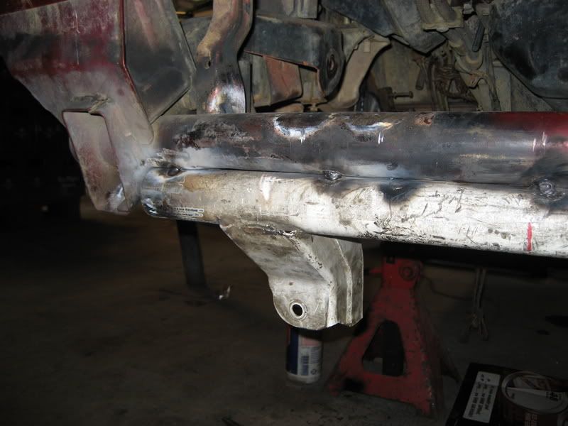

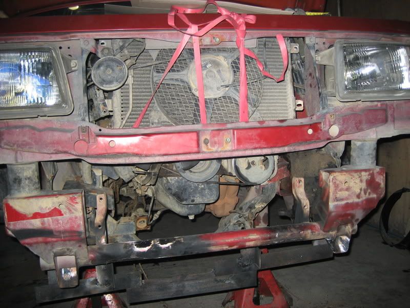

i have been toying with this idea for far too long. finally got it started last weekend.
im looking to drop my front a-arms by 2" and lift the vehicle by an inch. the other inch i will save for droop and better CV angle.
this would also give me clearance to drop my engine back to the original mount points for a lower center of gravity (i had raised my engine by 2" to make room for the toyota 3rd member) - http://www.zukiworld.com/forum/index.php?topic=8896.0
i hope everything goes as plan.  :)
donor chassis:
cleared the a-arm front mounts.

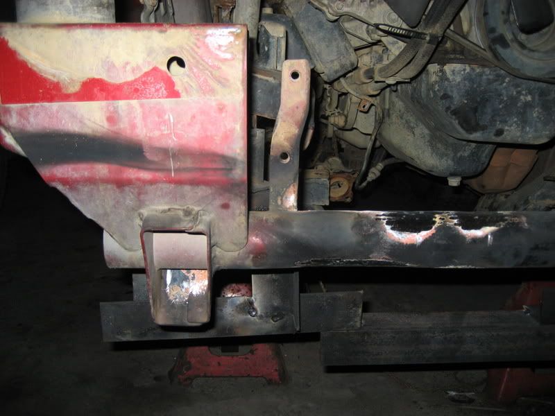

spot welding the donor front mounts. this saves me from precision dropping each mount and gives me a larger surface area for welding. the cross member diameter is almost a 2". perfect for my desired drop.
this weekend ill start the rear mounts.

Are you going to add some more bracing for that lower tube?  I would want to put something on to help insure it isn't going to break off if you hit a wall hard enough.

drone637- i will be reinforcing the lower tube after i finish the alignments.

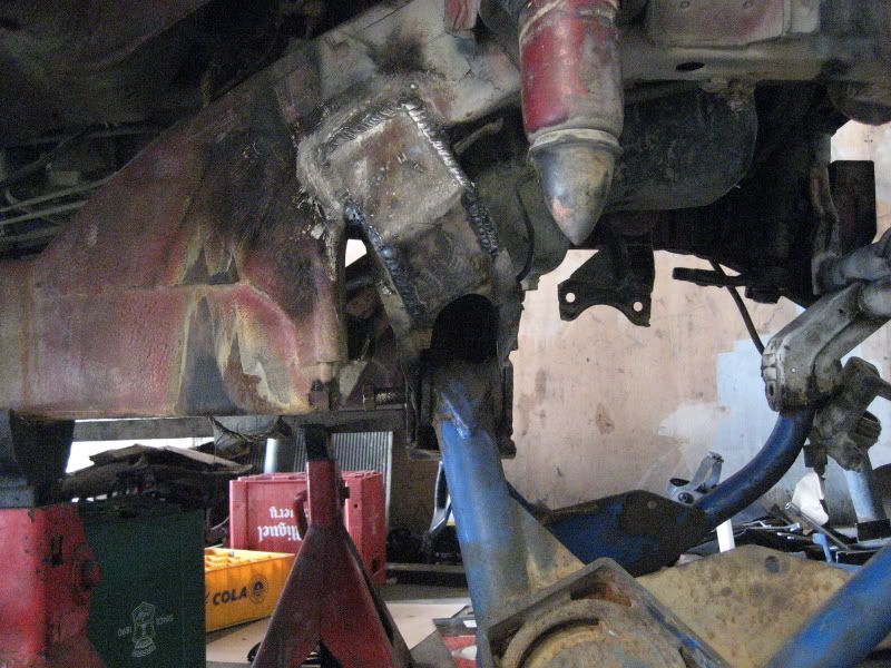

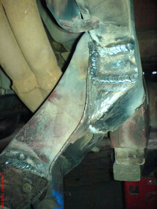

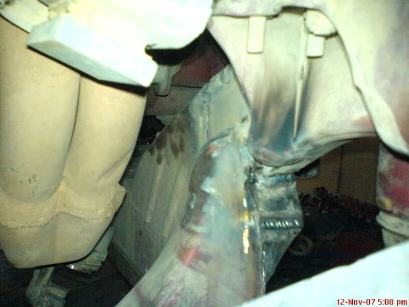

some pics on the lower rear mounts.
notice the hagen widening mod.  ;D
this would allow me to drop the front diff further and save my CVs.

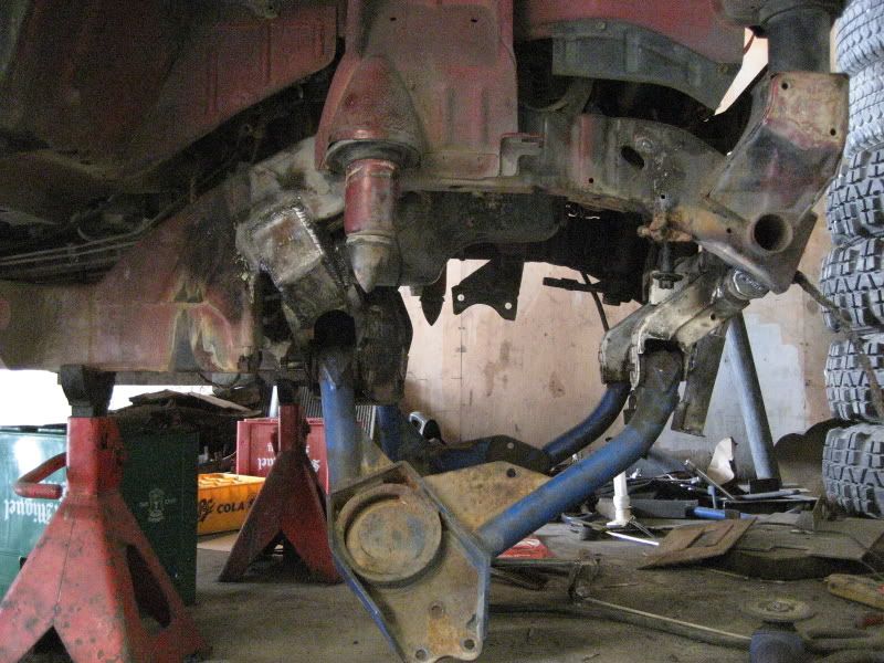

side view

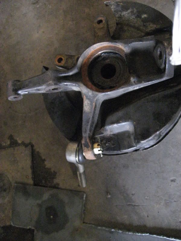

the hubs are machined to fix the tie rod mounts. had the tie rod mounted on the top instead.
